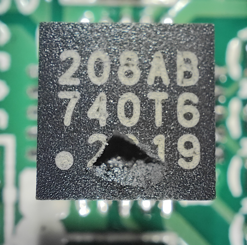

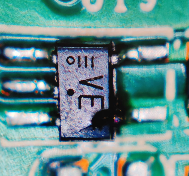

DankPro did you manage with repair finally? I have XR500 with the same symptoms, only solid USB2 LED and LAN LED for active ports etc. I found on the PCB two broken components, one around voltage supply socket and second near to the NAND module, one of them I have replaced and I am trying to buy the second one. If you have still the broken XR500 unit, we can try to take a look for some broken smd components at your router etc, I suppose that the solid usb2 can be occured by the hardware issue and maybe CPU cannot read the NAND etc.
WBR, Drzewiec
