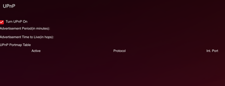

UPnP Portmap Table empty/blank
Hello team, I recently joined the Netgear family and im very happy with my XR500. i've been using it since last week and still cant find the way to add my PS4 pro to the Upnp list, i need assiatn...

It is most likely that UPnP is opening the ports but just not showing it. Do you have an Open NAT on the console (NAT Type 2)? What firmware version are you using?

Hello Netduma-Faser,
Thank you so much for the quick answer, I do have a NAT type 2, im using the firmware version V2.3.2.114.
- Netduma-FraserFeb 24, 2021NetDuma PartnerOkay that will be absolutely fine, it is just an aesthetic issue but I have raised it with NG and they will look into it.
