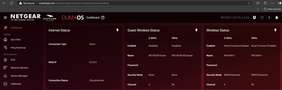

With my XR1000v1, after it was powered ON and ready and NOT connected to any ISP modem, using MS Edge, was able to log into the web page at both 192.168.1.1 and routerlogin.net:

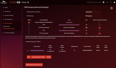

Checked the USB settings and enabled the folowing:

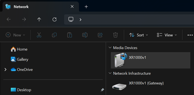

After it was enabled, I rebooted the router and during the reboot, I connected the USB drive to the back USB 3.0 port of the router. After the drive was ready, I opened Network icon on the deak stop and found the XR1000 media being displayed:

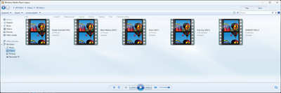

RIght selecting on the icon, I selected Open in Media Player:
Media files are playable here. All this was with out the router connected to anything. XR1000 is not valid web page access here on mine nor is XR1000v1. 192.168.1.1 or routerlogin.net works for me.

In your USB settings, you have your "Network/Device Name" set to "readyshare". Lower in the page, it shows your valid string for the network share is "\\readyshare". Mine is named "XR1000", so "\\XR1000" is valid, not because it is the router's model name, but because I deliberately set "Network/Device Name" to "XR1000". With this, it shows lower in my page that "\\XR1000" is the string to use.
Other than that, I can not explain why yours works and mine does not. Looking at your media player, I'm betting that if you clicked in the address bar to see the full path, it would show "\\xr1000v1\....etc". This is strange given that you have your "Network/Device Name" set to "readyshare" not "xr1000v1". My best guess is you also have DLNA Media Server enabled and it's name was set to "xr1000v1". This is found on "Media Server" page under "USB Functions".

MS Edge caches was cleared prior to connecting to the routers web UI. So all was new and clear with the browser and saw no issues using IP address or host name to access the web ui.
