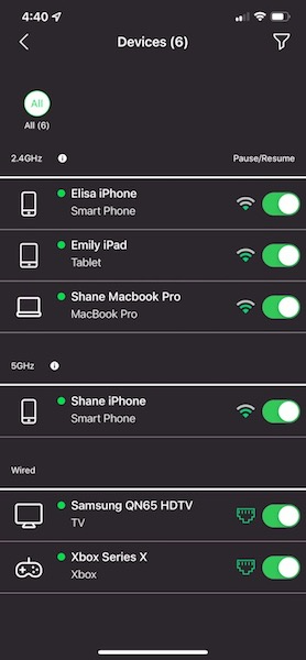

Weak WiFi signal. Signal strength doesn't go up even placing phone directly next to router or antenea.
2.4GHz device named Elisa iPhone was in same room with clear line of sight. Approximately  4ft away from router.
5GHz device named Shane iPhone was 1inch from router for testing. Even directly next to the router signal strength was minus 1.
EDIT: Not sure why the image isn't showing up. I attached the image as well.
