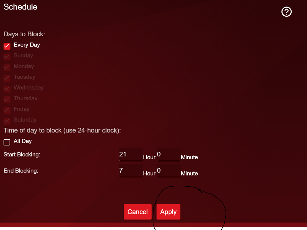

I've passed this on directly to the XR700 lead at NG so will hopefully get a response soon.So now Netgear has another Security Update. This is version 1.0.1.36 with lots of Securtiy Fixes. But just like the previous update 1.0.1.34, the Content Filtering Schedule is still broken. Netgear broke this with the version 1.0.1.34 and even after I brought this up several times at different locations including here, it's still broken! It doesn't kick in at 21.00 like its suppose to and so it also doesn't turn back on at 7.00AM. Why??????? This is how I control Services access to my Son's Devices.
Netduma-Fraser wrote:
I've passed this on directly to the XR700 lead at NG so will hopefully get a response soon. - martyr444Dec 17, 2020Apprentice
The only way the blocked services schedule works with these lastest Firmware updates is for me to manually click apply at 9PM to get it to start. And then to get it to stop I have to click apply again as seen in the photo at 7AM. That defeats the whole purpose of having a schedule that works automatically by using your set time. This should be an easy fix. I don't know what they did to break this. Please get this fixed!
- Netduma-FraserDec 18, 2020NetDuma PartnerI'd recommend you upgrade to the 3.0 beta and use the Traffic Controller feature instead, you can do the same thing as well as being a lot more specific.
- martyr444Dec 18, 2020Apprentice
Where do I find that? I would still like for them to fix this since it's suppose to be working on these paid for Devices.
- Netduma-FraserDec 18, 2020NetDuma PartnerYou can find that here: https://community.netgear.com/t5/Nighthawk-Pro-Gaming-DumaOS-3-0/bd-p/en-home-beta-npg-duma
