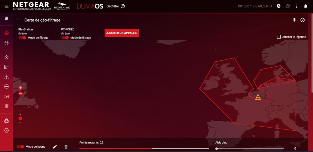

Can you provide a screenshot of what you're seeing on the map when you're getting that server please?
- FED1920Jun 08, 2023Tutor
- Netduma-FraserJun 09, 2023NetDuma PartnerAh I see, the Geo-Filter has actually blocked the server but it appears the game only tries to properly connect when you're already trying to load in, a similar thing happens with Fortnite, unfortunately there isn't a way around that at the moment.
