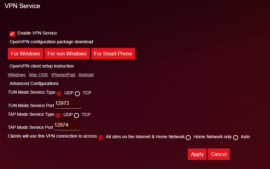

XR1000 Enabling VPN service stops internet / DNS from working.
Items I have tried: (more than twice each) reflashed firmware Factory default through web browser Factory default using reset button Created VPN on differnt ports using UDP All three options fo...

- basilverthornNov 11, 2025Tutor
It has worked perfectly before, I agree.
But no reson I should not be able to have DHCP, DDNS and OpenVPN all done by my router. I see no options under OpenVPN, I wish there was unless I am missing something someplace.
Thank you for the response, I will try some of this. Feels like I have in testing but do not recall.
I do not have an option to you list on the XR1000. Firmware version xr1000 1.0.2.86_2.1.40.
I do not have the option for number 3 either, but sure wish I did, most of previous routers do. unless im missing some top secret menu.
If I disable DDNS everything works. But if I disable OpenVPN and leave DDNS on everything works.
