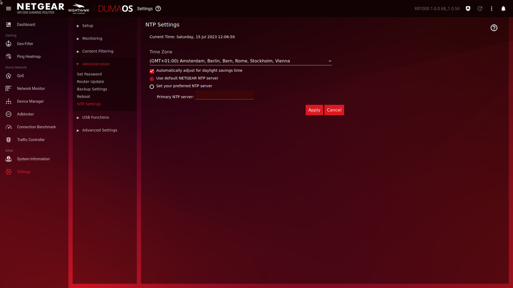

- theo-vInitiate
Problem solved
In my case some websites were blocked.
I noticed that the time in the router was not correct because of a wrong timezone.
After adjusting the right time zone everything worked fine.- I checked that already…was one of the first things I found when searching for it.
