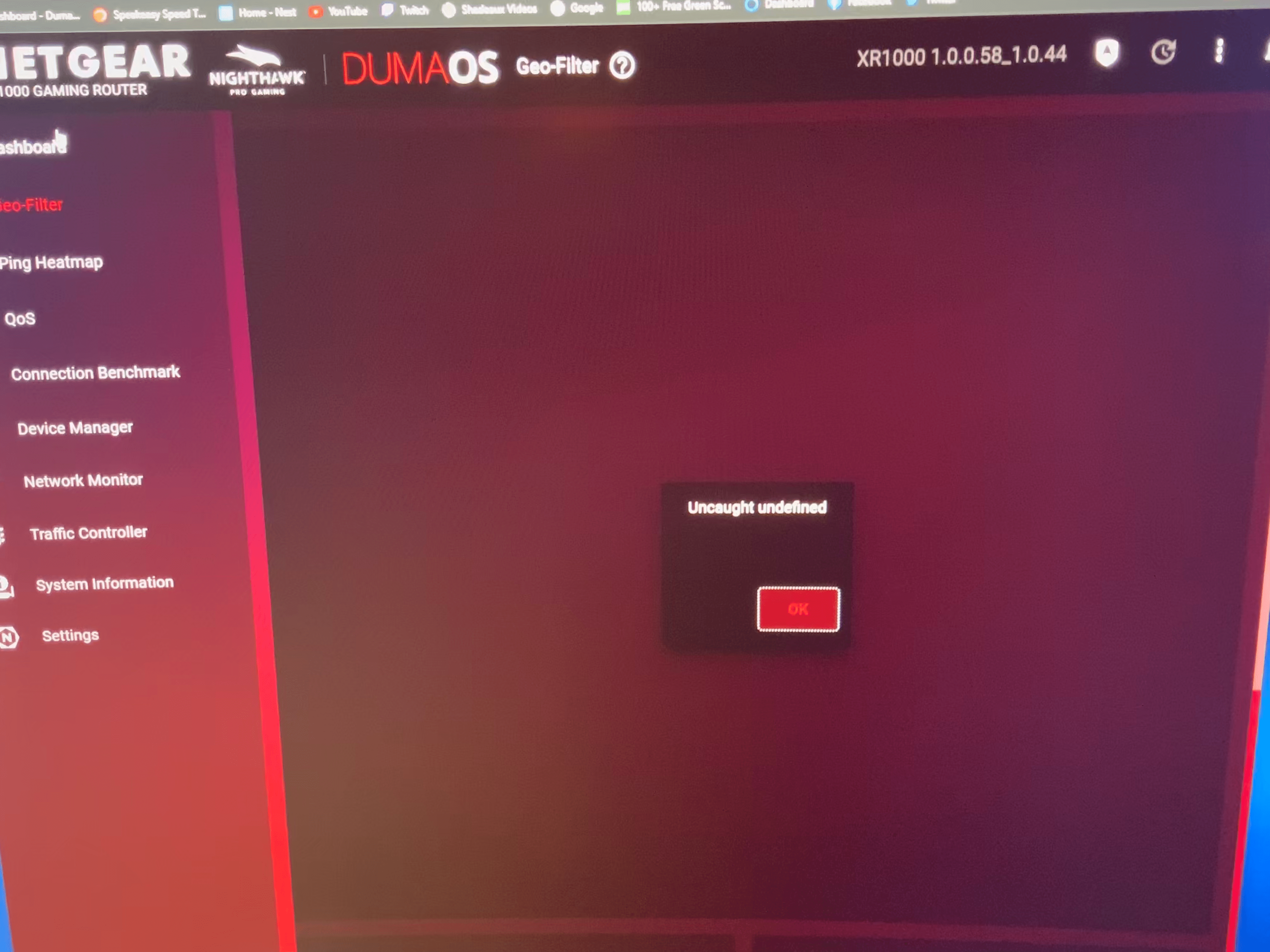

I have been trying to use GeoFilter on my newly purchased XR1000 router through DumaOS and it will not open. Firmware version 1.0.0.58 Any suggestions would be appreciated.
Shadeaux
Dec 20, 2021Star

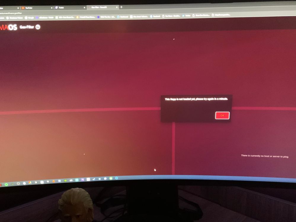

Well, I did factory reset by holding in the pin on the back...went through setup...reset router before logging into UI. Waited 5 minutes. Logged in. Still does same thing. Throws uncaught exception, then says Rapp not loaded on geofilter and ping heatmap. Everything else works fine. Even auto ping on geofilter page works. Not the other 2 boxes, though.
Netduma-Liam
Dec 21, 2021NetDuma Partner
As you're still getting the error, I believe you'll need to downgrade back to the previous firmware, then upgrade back to the new one again. That should resolve the issue for you.

- ShadeauxDec 21, 2021StarSo I downgraded to the 50 version firmware that I downloaded from your site. Reset router with pin on back and started all over. I skipped the upgrade during setup. The 50 version throws exact same error.
- Netduma-FraserDec 21, 2021NetDuma PartnerIs that with Armor disabled?
I have never activated armor...it shows as unactivated when I click armor icon in top right.
I went ahead an let firmware upgrade to latest. Waited. Same result.

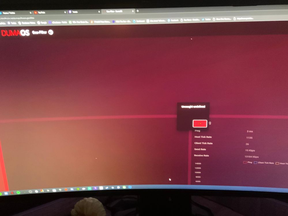

- Netduma-FraserDec 21, 2021NetDuma PartnerCan you provide a full screen screenshot when you're getting the error please so I can see if anything is amiss
- Netduma-FraserDec 21, 2021NetDuma PartnerCould you take a full screenshot please so I can see the browser and all the interface https://support.microsoft.com/en-us/windows/use-snipping-tool-to-capture-screenshots-00246869-1843-655f-f220-97299b865f6b

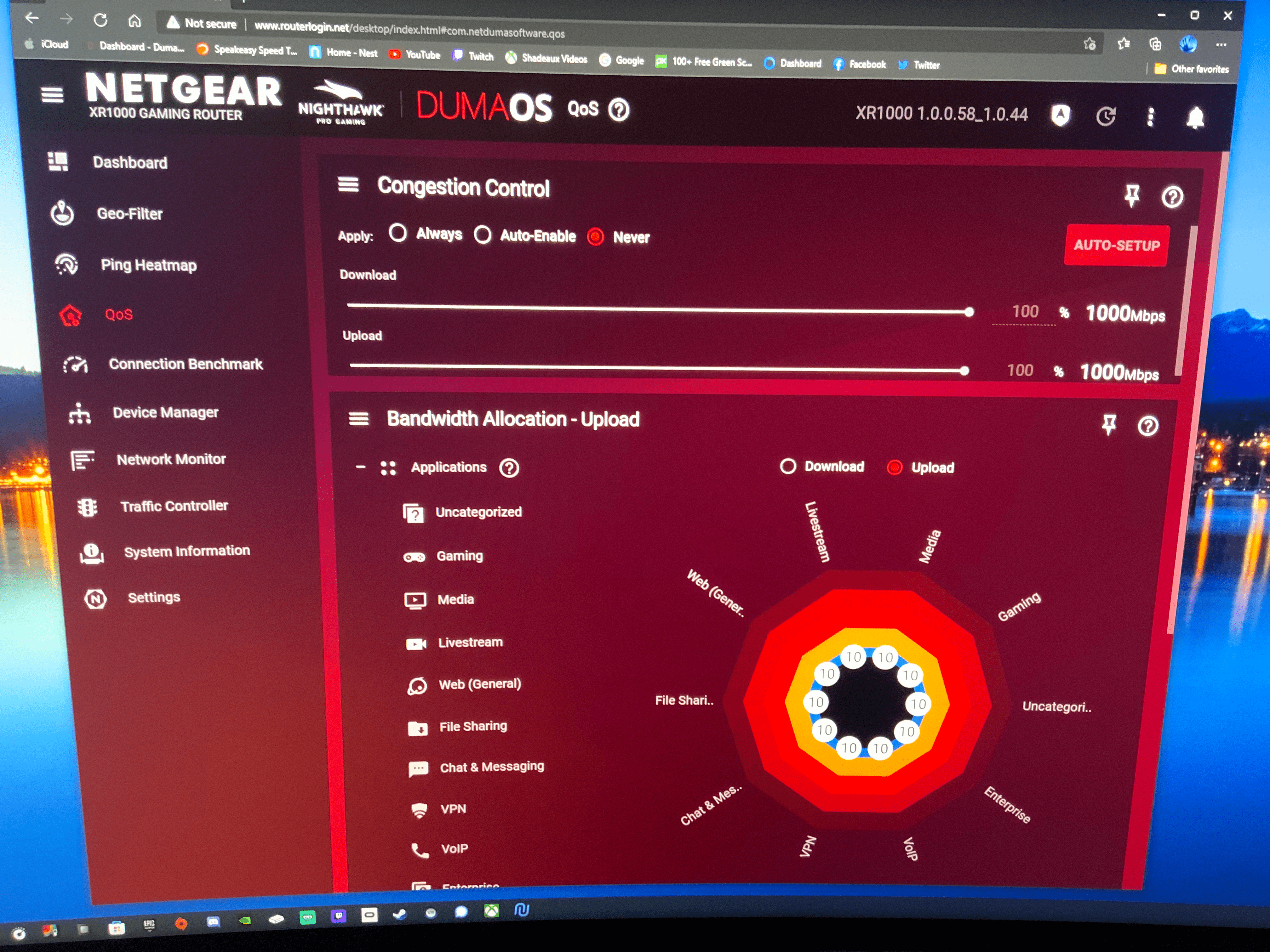

Everything works..except Geofilter and heatmap.
- Netduma-FraserDec 21, 2021NetDuma PartnerI think the best thing to do would be to reinstall using TFTP and follow the method I posted here: https://community.netgear.com/t5/Nighthawk-Pro-Gaming-Routers/XR1000-GeoFilter-quot-The-Rapp-is-not-loaded-yet-please-try/m-p/2165978/highlight/true#M27760
