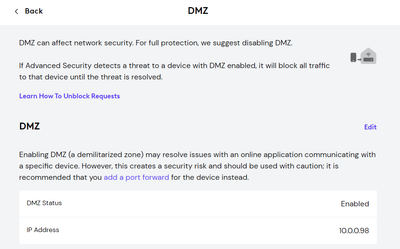

Have you tried leaving the ISP's device in router mode (disable its wifi) and put the netgears IP address into its DMZ?

I have just done this and will let you know if it corrects the issue. Wi-Fi is off and the Nighthawk router is in the DMZ (It has a an IP of 10.0.0.98)
Internet Status
Connection Type DHCP
WAN IP 10.0.0.98
Connection Status Connected

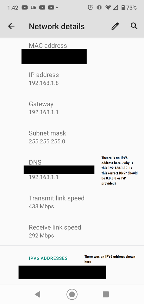

Ok I am back again - I have stuck with this setup and it has been about the same or maybe a bit worse. Issue still only happens to certain devices on Wi-Fi - commonly manifests in the following way - I will have my Android phone connected to 5g Wi-Fi. The device will function fine - I will commonly use Chromecast and send YouTube to a Chromecast on network without issue - while this is still working often if I use any other app or even attempt to move around on YouTube - I get Offline or no Internet. If I turn off Wi-Fi and turn it back on I get right back on no issue. This has only been happening since I have used this Netgear XR1000. I have tried turning the Anonymize MAC option off on my phone and turning it back on - no difference.
Before this I used an old TP-Link WDR-3600 but did not have any issue like this at all. It was using stock Linksys firmware for it's entire life. Same Xfinity Modem on both routers. This issue never happens on wired devices.

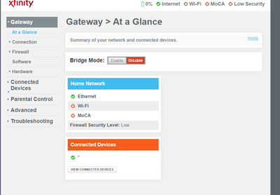

I am going to try putting the Xfinity Modem/Router back into Bridge mode (I was doing the DMZ to my Netgear as suggested) because the other thing that happens when I go out of bridge mode is that I can never get my Security Cameras to work properly if NOT in bridge mode. (In bridge mode I have the Port forward setup and they work with IPCAM software via public IP)

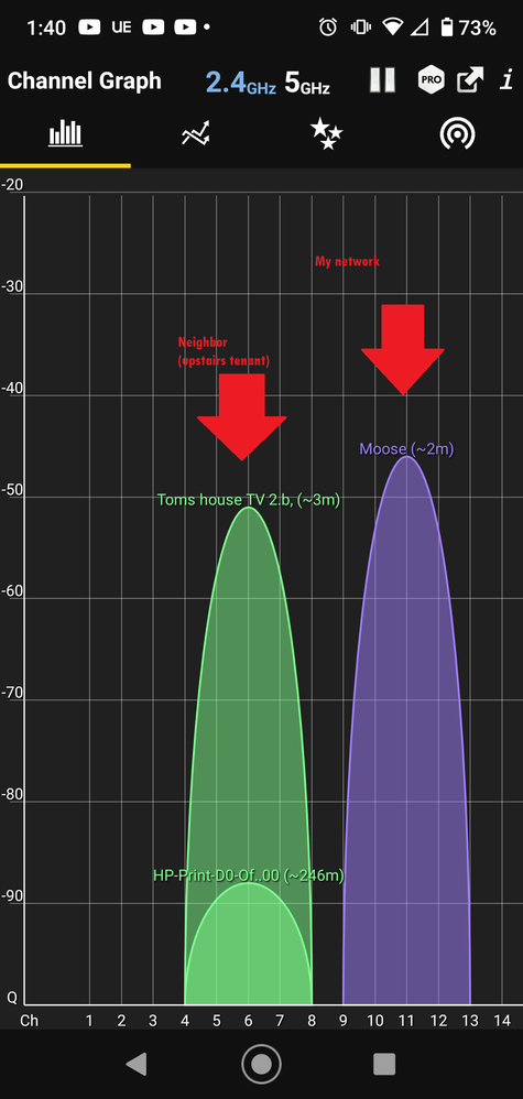

- Netduma-FraserApr 24, 2022NetDuma PartnerKeep the private mac address option off as that will help. For WiFi try these suggestions:
Use a WiFi analyzer to find the least congested channel and change to that
Ensure it's in an elevated position - not on a metal surface
Ensure there aren't any electrical / wireless devices e.g headphones etc within close proxity ~3 feet if possible
Set the antennae to this position _ | | _- RicktheracefanApr 24, 2022Star
