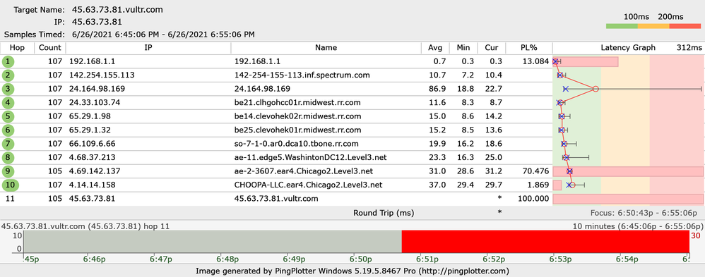

Hey Team, I hate to revive a solved thread. So I am using Ping Plotter and notice when I am using the router, every so often I get packet loss still. When I plug into modem directly, ping plotter picks up no issues. When I used the router, at first i was experiencing PL every 10 mins. It still happens but not at every 10 mins. When I do get PL, my router connection status all reset to 0 except lease time. When I play call of duty, i see a red bar on 2nd hop and carries all the way down to destination which in my case was pingplotter.com but i find this to be strange because I'm not getting PL when im directly into modem. My WAN time resets and my logs say "Internet connected" with a time sync after. Could this be a firmware issue with netgear?

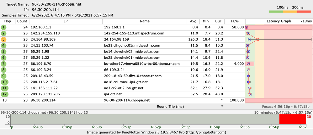

- InoculateJun 26, 2021Guide
Okay, you will see most of it is coming from router. Sometimes, I'll have 0 at the router and it'll start at hop 2 and carry down. Note: with COD servers, they wont allow you to ping their servers so it will always say 100% loss.
Here is an example of when my router reports zero and travels down the line from ISP.
- Netduma-FraserJun 27, 2021NetDuma PartnerThe packet loss shown on the hops don't matter, it's the packet loss shown on the bottom graph that is the mean thing but as you can't ping game servers effectively it's not as useful. Can you run a plot to a local news website or Google (8.8.8.8) and then provide a screenshot of those results please?
