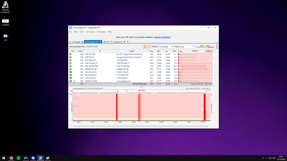

- peakitfDec 16, 2022ApprenticeAt the moment just an Alexa, my PC and my phone. Congestion control didn't have an effect which is why I was concerned of issues since from what I've seen, congestion control should nuke bufferbloat. What does this pingplotter result tell us?
- Netduma-FraserDec 16, 2022NetDuma PartnerI can't see the picture until it has been moderated, can you attach it directly? All devices should be connected to the router otherwise it can't properly control the network and won't be as effective.
- peakitfDec 16, 2022ApprenticeWell that's all the devices I really have, I don't have other internet users in the house, just me. I've attached the image instead, for some reason my router's IP says it's getting packet loss.
- Netduma-FraserDec 16, 2022NetDuma PartnerYou can ignore the first hop, that does show packet loss sometimes but isn't usually a cause for concern. You do have some packet loss on your line though, try again but use a more local website, such as a news site and see what you get.
