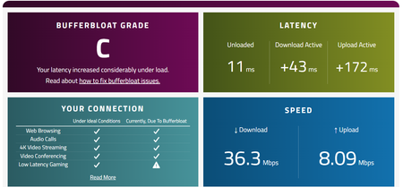

Hello I'm hoping someone can help/point me in the right direction. For about a month now, I've been receiving high upload ping, whilst underload. My hit registration in-game has been really poor in ...

Thanks for the reply.
Yeah I have replaced all cables and even got a new ISP router supplied.
I have the ISP supplied router in Bridge Mode to avoid double NAT.
Unless anyone else has any suggestions, going to the ISP to run tests is the way forward. Just didn't know if it was a known issue due to weird upload/download test results I showed.

- Netduma-FraserJul 18, 2024NetDuma PartnerAre you using PPPoE/VLAN/IPv6 by any chance?
- dpl001Jul 18, 2024GuideYes I am - PPPoE. I have been since before the issue started though
- Netduma-FraserJul 18, 2024NetDuma PartnerIn most cases like yours it'll be due to PPPoE, disable bridge mode on your ISP router, have it handle PPPoE instead, put the XR WAN IP in its DMZ instead then see if it works as expected
