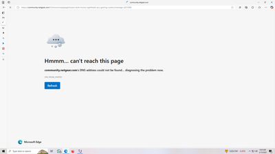

The Model number i got is this eu2251.
Here is a picture of what it looks like when it cant connect with the XR1000 v2
When i directly plug my computer into the modem i get a picture like a earth globe Icon on my tab of Edge, as if its hiting a brick wall then it connects to whatever website i was going to without giving me a error. It may take a second to download the whole page though. So there is a difference. Thanks.
