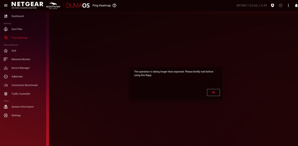

Hi,
I have also some trouble getting in the ping heatmap section. The geo filter works, but ping heatmap keeps showing this.
And also can you update the FIFA22 servers on xbox? Recently I keep showing I am getting peer servers when my in game ping is 22ms but my opponent was 8ms. The geo filter showed me my own location which is really weird, can you please look into this?
- Netduma-FraserJul 12, 2022NetDuma PartnerI can't see your picture as it needs to be moderated, could you attach it directly please? The Geo-Filter doesn't show your location so it was likely just very very close to you. Also the ping can differ between the Geo-Filter & game as the game may include processing delay (which all games have) in their ping calculation.
- louie0827Jul 12, 2022Aspirant
Do you have the list of FIFA22 servers right now in North America? Xbox series X nextgen specifically
- Netduma-LiamJul 13, 2022NetDuma Partner
If you reboot the XR, are you then able to load Ping Heatmap?
When did you first start noticing this problem? Did it occur after any configuration changes or firmware updates?
I don't have a list of servers to hand, the best thing to do would be to work out this problem so you can use Ping Heatmap for this.
