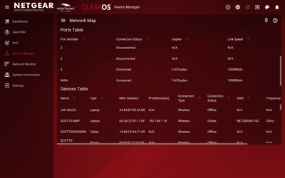

when I do a speed test through the nighthawk app, it is showing 150 down 76 up, but this fluctuates quite a bit and will often drop
see below
- Netduma-FraserDec 01, 2021NetDuma PartnerCan you attach a screenshot of the table view on the Device Manager please?
- SC00TADec 01, 2021Tutor
Im at work now, but will respond with the screen grab as soon as I can

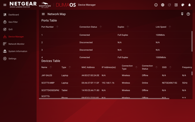

- SC00TADec 05, 2021Tutor
see device manager below
- Netduma-FraserDec 05, 2021NetDuma PartnerWhatever you had connected to the LAN port in the first screenshot is limited to 100 Mbits, either it's the ethernet cable or the ethernet adapter on the device is limited to that speed
