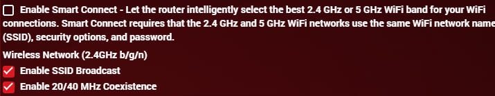

Current settings:
As I'm sure you are aware, that split my SSID into two, one for 2.4ghz and the other for 5ghz. By the naming convention it used, all my equipment reconnected to the 2.4ghz.
