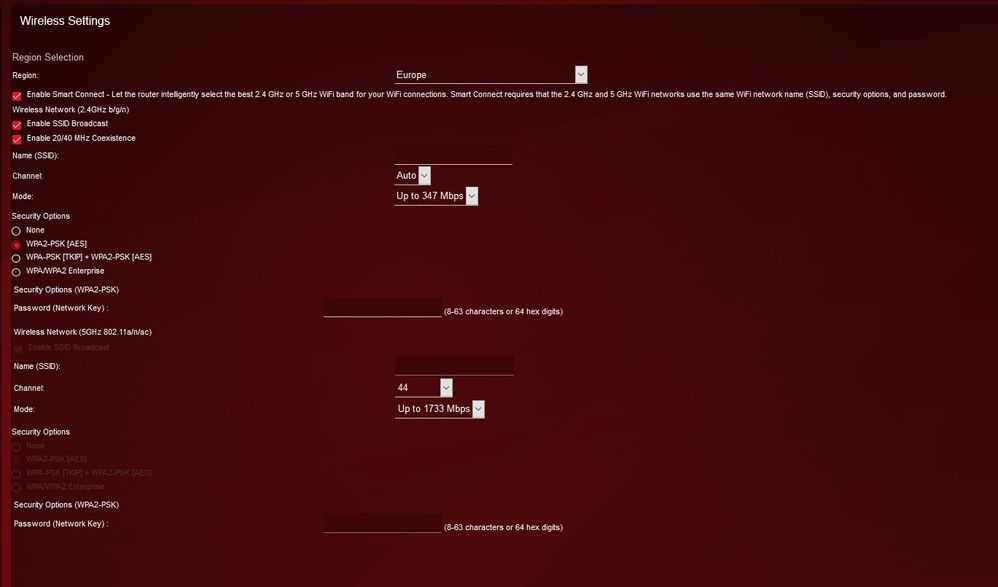

I've checked DumaOS and yes, smart connect is enabled.

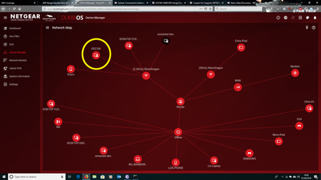

With regard to the offline PC - somehow over night it has resolved itself and now shows under the correct address on DumaOS

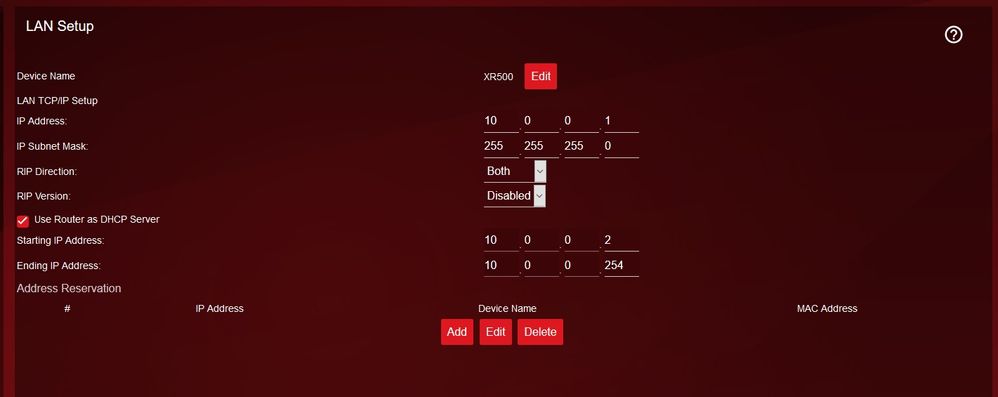

As for the printer it is under a static IP address which is different to the IP addresses asigned by the router - HP address is 192.168.1.132 - all current IP addresses are 10.0.0.x
So this is the only issue remaining when I get it right.

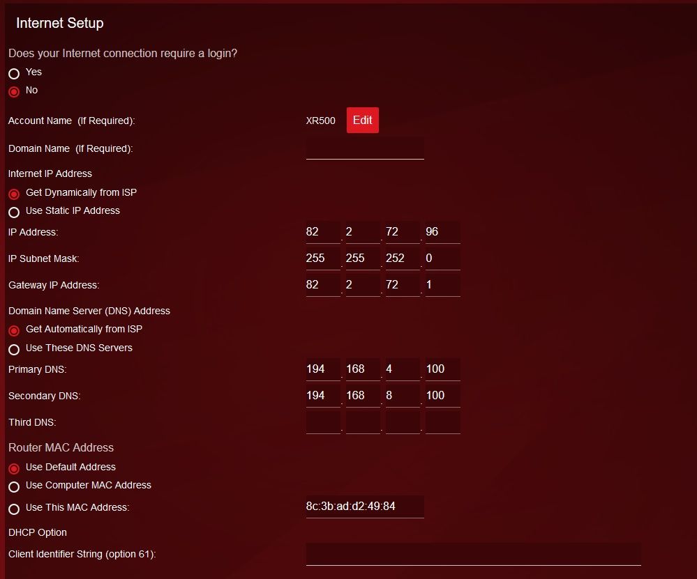

First think about why the XR500 has changed to the 10.0.0.x/24 network - this does happen typically under double NAT situations where e.g. a provider router does NAT and use the 192.168.1.x/24 network. Some of these (but less and less) can be re-configured to modem or transparent modes. If this is not feasible, change the HP config to DHCP, make a reservation for its IP-MAC pair on the router, and then you might consider changing it to that very same fixed IP.

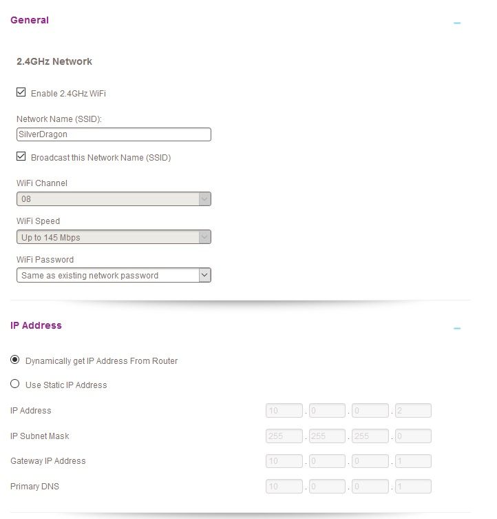

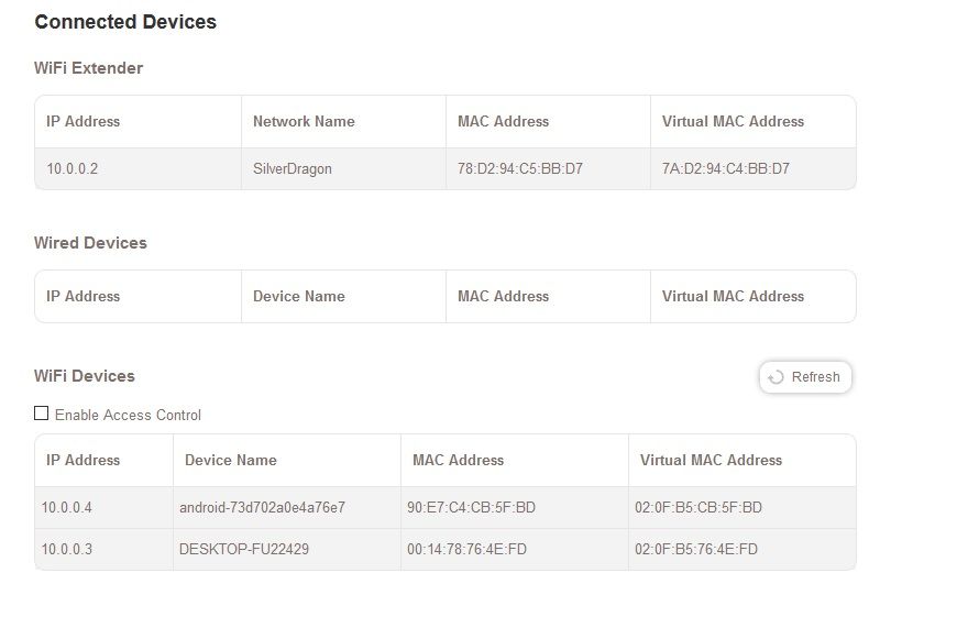

The big changes to this network and the old one (where the printer worked ok) that I can see is that I'm now using a Virgin cable modem connected to the XR500 and as mentioned before the EX2700 extender to get decent signal in the office room.
I'll try and get more screen shots up of as much relevant information as I can, as I have a feeling I'm not explaining this very well

I know this isn't an optimal solution, but if you connect the extender to your Virgin hub, does the printer work? This would narrow down if the issue is with the XR500 or whether it's related something between the printer and the extender
