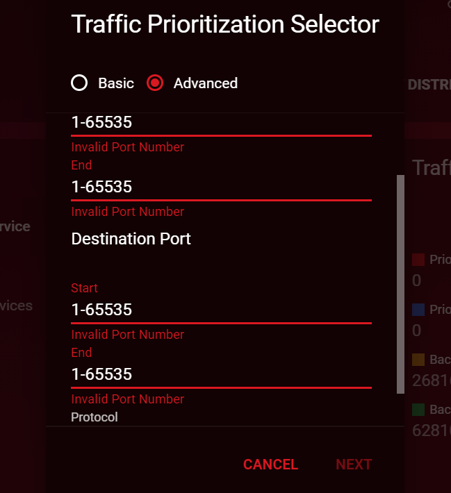

- Netduma-FraserJun 09, 2021NetDuma PartnerEnable QoS, make a custom rule for Traffic Prioritization:
Source 1-65535
Destination 1-65535
Protocol TCP/UDP
then test the speeds on that device and see what you get please.- GidgriffJun 09, 2021Guide
Says invalid port number
