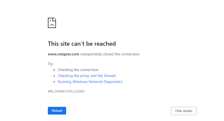

Not sure whats going on if im honest. I have turned the PPPoE settings off on my XR, its connected via the internet port to the Smart Hub 2, all blue lights on and wont even let me on the Router menu and says no internet connection. Even after a reset?
- GidgriffJun 18, 2021Guide
www.netgear.com unexpectedly closed the connection.
Try:
- Checking the connection
- Checking the proxy and the firewall
- Running Windows Network Diagnostics
ERR_CONNECTION_CLOSEDThats what im getting when im trying to set up the router after the reset. - Netduma-FraserJun 18, 2021NetDuma PartnerYou need to go to http://192.168.1.1 or http://routerlogin.net and you should be able to access to setup

Got about half way through set up and my screen went white and had a symbol and this - www.netgear.com unexpectedly closed the connection.
And now it wont go passed this and goes to this screen every time i click on the link to go through to set up :(
