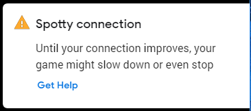

Greetings, I am trying to troubleshoot an issue with the XR500 and Google Project Stream. I am streaming Assassins Creed Odyssey from Project Stream and whenever I start to play I receive the following error.  The game gets choppy and then it becomes somewhat unplayable due to the lag.

  • As DMZ resolves the issue it is to do with ports. You'll need to find out what ports are required for the service them and then forward them for your PC. You can then take the PC out of DMZ and it'll work.
