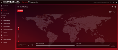

- Mike40Dec 08, 2024Luminary
I did everything you said and now BO6 does show up in Ping Heatmap but I still get no ping. This is a SS from while I was in a match. According to the Geo-Filter, I wasn't even connected to anything.
- Netduma-FraserDec 08, 2024NetDuma PartnerCan you attach it directly please? I can't see it otherwise until it's been moderated
The one I attached is with my PC in console. The SS you couldn't see I had nothing in Geo-Filter but still the same thing. There is no ping to any server/player while I'm in the game.
