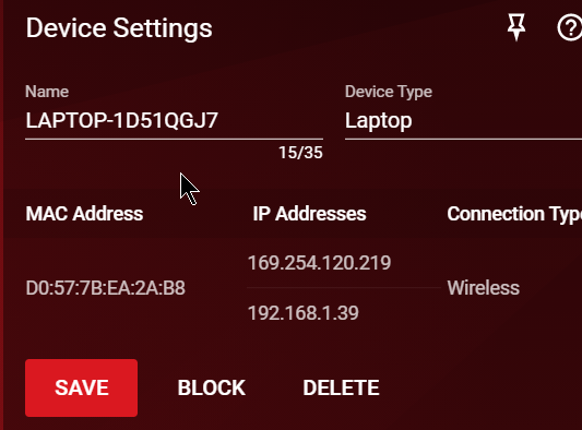

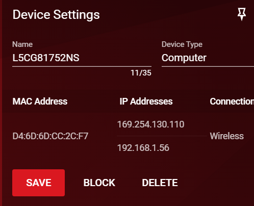

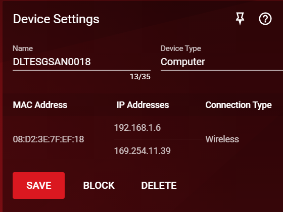

Also found 2 more devices with the same APR parsing error and observing their IP addr found TWO addresses simultaneously.
didn't see APR table error for the last device but it also has 2 ip addresses...
- Netduma-FraserJan 14, 2021NetDuma PartnerLooks like they were given an IP that corresponds to when they didn't have internet, that shouldn't cause any issues though as they will use the 192 address.
