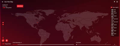

XR500 Geo-Filtering not working for COD
Just recently I noticed my games have been crazy lagging. I only play COD on my PC. I live about 50 miles (give or take) from the Chicago server. The server is trash so I pick a server in northern...

That does sound like there is an inherent issue then that the router potentially won't be able to resolve. Is the PC showing online on the Device Manager? How have you added it to the Geo-Filter?
- Mike40Jul 25, 2024Luminary
PC shows online 24/7 since I never turn it off. I haven't changed any settings or done anything with the router. All of a sudden the Geo-Filter just stopped working. I had it set up as COD - PC and have had it set up as just COD for the filter. I just tried launching the game and now there are no COD servers online in the world which I find rather hard to believe.

- Mike40Jul 25, 2024LuminaryNow the Geo-Filter magically works again after not working for a couple weeks but there is another issue now. I'm using the app and I can see that I'm connected to the Georgia server. It's says no game activity connected and on the Geo- Filter page on the top it just gives me the circle of death. Usually, it will tell me the location of the server. Currently I have my PC in Geo-Filter and I'm using COD settings not COD-PC. If I use PC it says in the description it won't work which it doesn't. I'm also getting non-stop packet loses.
- Netduma-FraserJul 26, 2024NetDuma PartnerThe app is based on DumaOS 4 so there may be some discrepancies between the app and the version you're on which is why you're seeing that.
Try this:
Quit the application/game/client completely
Remove device from the Geo-Filter
Give PC PlayStation Device Type in the Device Manager
Resync from the Geo-Filter Map menu
Re-add the device to the Geo-Filter with the manual option
Set up the Geo-Filter how you like
Wait 2 minutes
Boot up application/game/client
It should be more consistent after that.
