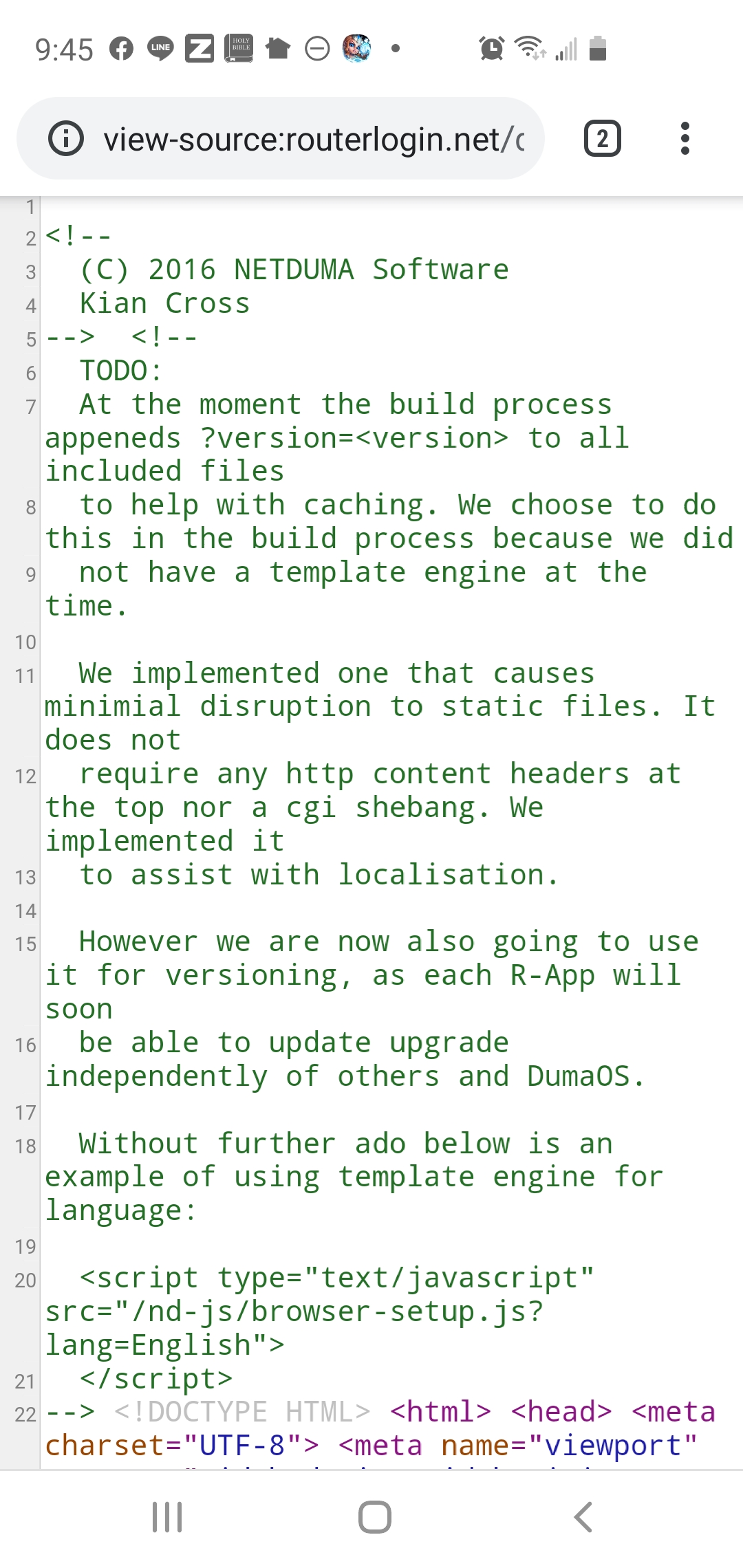

- GamerDuDeFeb 18, 2020GuideHere is a screen shot of the view source after it froze on me. May e you can make sense of what it means
- Netduma_AlexFeb 19, 2020NetDuma Partner
The view source won't help us much, we really need to see the Elements tab in the debug menu. I don't know if the mobile version of Chrome has this, a quick search online suggests that it doesn't.
