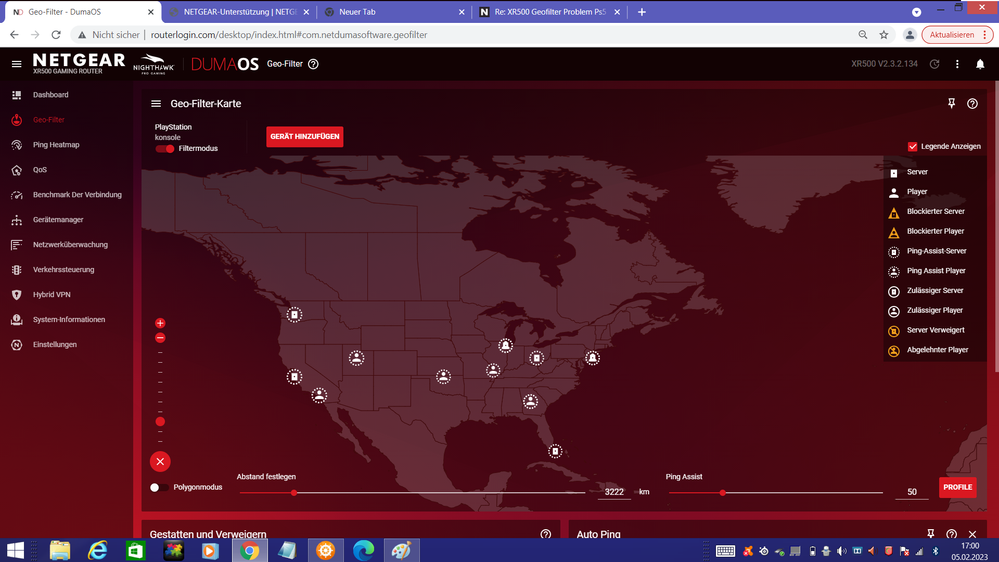

Hallo ich habe eine Frage bzw ein Problem. Ich nutze VPN (keepsolid open vpn) und den Geofilter . Aber ich finde ohne Crossplay keine Spiele.Natürlich habe ich den Geofilter richtig eingestellt . Habe...

- Marv-KFeb 06, 2023GuideI've tried that many times. As soon as I only use the geofilter it doesn't work at all. The ping doesn't change there and I find the same lobbies as without the geofilter. Very annoying, unfortunately..
- Netduma-FraserFeb 06, 2023NetDuma PartnerCan you provide a screenshot of the Geo-Filter page when you're getting the same games as usual? What do you mean 3 PlayStation options?
When I start the game, the servers are displayed on the geofilter for a few seconds, but then they disappear again immediately. And I also don't ping any server in this circle (North America) because I have the same ping as when I disabled Geofilter and VPN. Of course, I also activate the filter before the game starts and select the region. I'm doing everything right and I've tried everything. But it doesn't work.
- Marv-KFeb 06, 2023GuideIn addition, I am shown 3 * Playstation options where I could filter. You have to try it first to know which is the right device.
