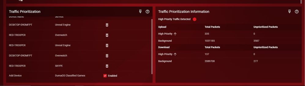

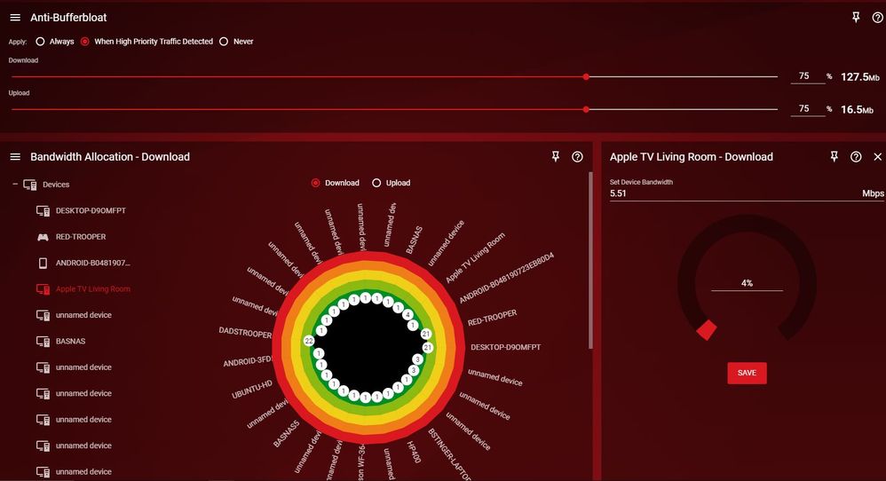

Screenshots haven't loaded yet, if you could upload to imgur that would be helpful
bsilverthorn
Aug 12, 2018Apprentice
odd they show right above my text now. I PMd them to you.
- bsilverthornAug 12, 2018Apprentice
- Netduma-FraserAug 12, 2018NetDuma PartnerStill cant see it, think it takes a little to upload properly, will check back
ok very odd, I can see them now when I log out and back in also PM'd them to you.
- Netduma-FraserAug 13, 2018NetDuma PartnerCan see the screenshots now. I would change Anti-Bufferbloat to 'Always' and double check that share excess is on for both download & upload of bandwidth allocation.

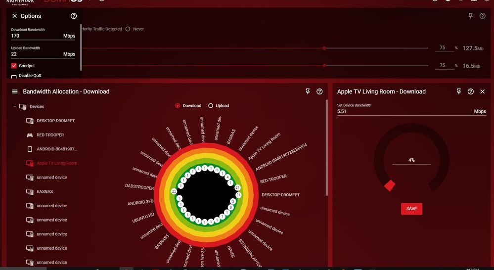

Turning QOS to Always seems to be the answer, but I wish it wasnt the solution. I would rather have the true 180 meg when no one else using the internet instead of 80% of it. Maybe there is a setting here I need to tweak as I am noonb to duma.
Brett
- Netduma-FraserAug 22, 2018NetDuma PartnerIs it only one device that is unable to connect using that channel?
Setting to Always is optimal so you never experience any local congestion but you could set it to when high priority detected and then based on your Traffic Prioritization settings will only apply your Anti-Bufferbloat percentages when gaming is detected. - bsilverthornAug 31, 2018Apprentice

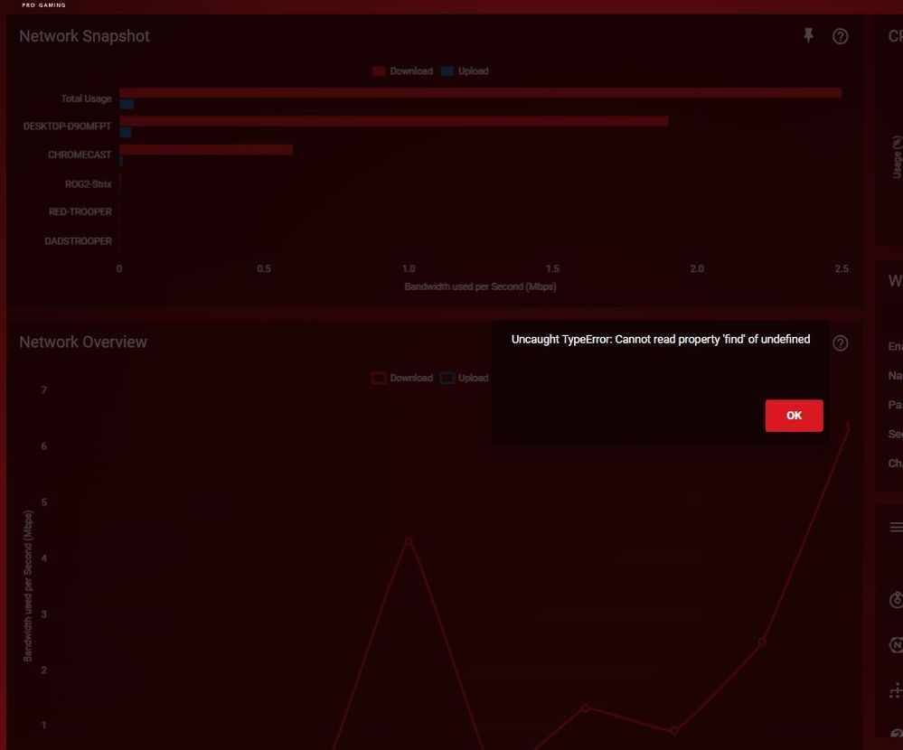

Not sure whats up, but I get a lot of these type errors navigating the OS or just sitting on the dashboard watching whats going out the router.
- Netduma-FraserSep 09, 2018NetDuma PartnerWhats the error? Can't see the picture at the moment
- bsilverthornSep 09, 2018Apprentice

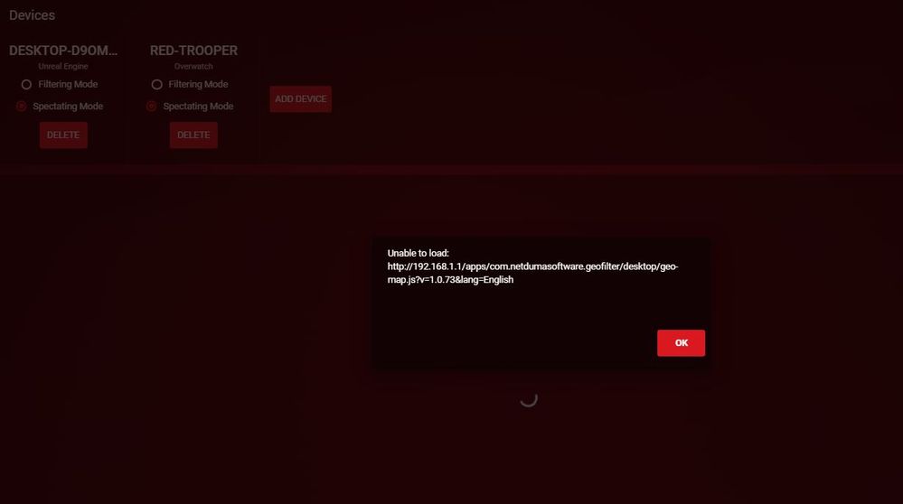

Error 1:
Uncaught TypeError: Cannot read property "find" undefined
Error 2:
Unable to Load:
http://192.168.1.1/apps/com.netdumasoftware.geofilter/desktop/geomaps.js?v=1.073&lang=English
Doesnt matter if router is rebooted etc... This happened right after a reboot, tried flush cloud etc... Happens daily for some reason in Chrome or Firefox
- Netduma_JackSep 10, 2018NetDuma Partner
Hi - please check out this guide which could help you with that: https://kb.netgear.com/000053845/Why-do-I-see-uncaught-error-messages-showing-up-on-my-XR500-when-I-log-in
