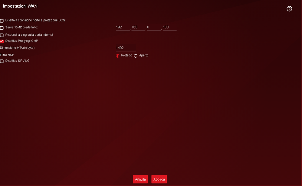

potrebbero essere i Dns nel router il problema? [192.168.1.1]
magari non li rileva come dns? il modem è un tim hub con connessione ppoee
- Netduma-FraserFeb 27, 2019NetDuma PartnerThat's a decent ping. I can't see the pictures as they haven't been moderated yet. No that DNS means it will look to the router for the DNS which it will get from your modem. Are you able to get the hub to handle PPPoE rather than the XR500?

Ok, so I leave the ip wan address so I do not use ppoe so it should be better? I put the static ip on both the router and the modem and put the mtu on the router at 1500 the sip alg filter by turning off I can notice better line?
- Netduma-FraserMar 05, 2019NetDuma PartnerIf you get an internet connection without PPPoE then no need for it. Yes that sounds fine

The ISP requires a PPPoE connection there is no way around the encapsulation (complete unrelated to QoS).... and it's unlikley an MTU of 1500 is possible at all.
- ManuellllMar 06, 2019Apprentice
so i advise you to put the ppoe and disable nat on the modem? or simply put the mtu to 1492 and that's it? I'm confused
- Netduma-FraserMar 06, 2019NetDuma PartnerIf PPPoE was absolutely necessary you wouldn't have an internet connection without it through the router. So that tells me that it's an option they provide, that you can use PPPoE. It's been seen in the past that PPPoE does not work fully with QoS which is something for us to work on. So if it's not necessary I would advise not using PPPoE.

Ref the MTU - you have to run the classic check with ping to discover the packet size possible without fragementtion.
Start a ping test with a ICMP payload size size of 1472 bytes, reduce buffer size by 8 byte (1472-8 = 1464, 1456, 1404, etc.) until you get 0% packet LOSS and no more DF required.
ping -f -l 1472 www.google.com
...Example
C:\>ping -f -l 1472 www.google.com
Ping wird ausgeführt für www.google.com [216.58.215.228] mit 1472 Bytes Daten:
Antwort von 172.16.116.1: Paket müsste fragmentiert werden, DF-Flag ist jedoch gesetzt.
Paket müsste fragmentiert werden, DF-Flag ist jedoch gesetzt.Ping-Statistik für 216.58.215.228:
Pakete: Gesendet = 3, Empfangen = 1, Verloren = 2
(66% Verlust),
STRG-C
^C
C:\>ping -f -l 1464 www.google.comPing wird ausgeführt für www.google.com [216.58.215.228] mit 1464 Bytes Daten:
Antwort von 216.58.215.228: Bytes=64 (gesendet 1464) Zeit=9ms TTL=54
'C
At the point where the DF is no longer required, add 20 for the IP header plus 8 for the ICMP header), so here 1464+20+8 so the optimal Internet interface MTU will be 1492. - ManuellllMar 08, 2019Apprentice
