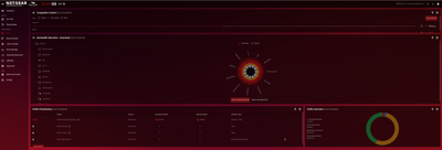

- Netduma-FraserNetDuma PartnerCould you provide a screenshot of your QoS page please?
- Mike40Luminary
I had to shrink my screen to get the whole page in.
If you need anything else, please let me know.- Netduma-FraserNetDuma PartnerYou'd definitely need to manually enter your speeds to get anyway close to them. Have you disabled Share Excess in Bandwidth Allocation settings at all?
