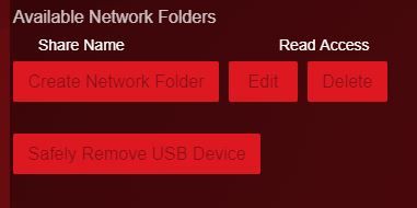

XR500 readyshare not working?
Hello,
I am using a XR500 and want to use the USB storage option via the USB ports on the router.
I cant get it to work.
using the latest firmware and WIn10 pro 1803
USB setting is set to ON ...

Hi, I have the solution. You have to use drives with USB3.0 connectors (the blue socket).
With the 3 (older) USB2.0 devices I tried, its not working.
I will upgrade the HDD's, and insert them into a USB3.0 capable housing.
