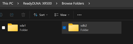

There are a couple of ways to access those drives. 1 is to map 'em which I can do on 2 W10s. I don't see how on W11.The other way is directly which works on both W10 and W11.
EXPLORER: This PC. In right hand side, Network locations select ReadyDLNA:XR500 (Media Server). New window. Select Browse Fo;ders folder. New window shows each drive ... i.e. sda1 folder and sda2 folder.I can get at the drives on any machine as described above. I cannot MAP to them on W11.

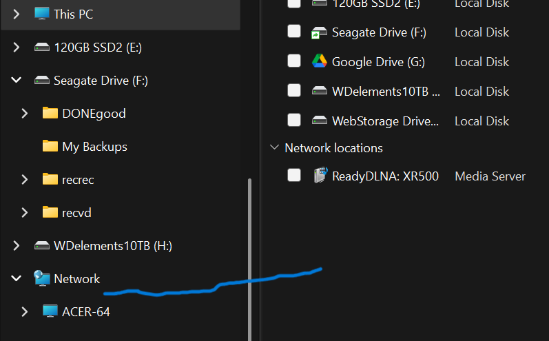

- WacoJohnApr 07, 2025Luminary
Your screenshot shows a router R7800 under NETWORK in Explorer. I have no router listed ... only another machine on the network. Can't then map. scroll down slightly on this screenshot.
