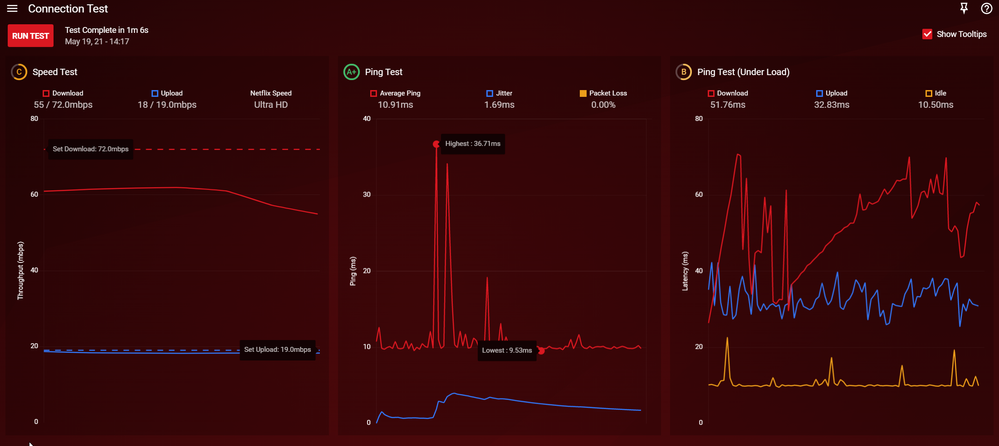

I'm having issues with my ping under load and regularly FIFA on Xbox feels dramatically less responsive when video is streaming. I've installed firmware 120 and erased and reset but I've noticed my QoS settings all remain and I get an error when opening it -device not found. How would you advise? Feel like it's not actually reset properly and not sure how to proceed.

Would it also be possible to send over a screenshot of a completed connection benchmark?

General speeds seem down from my maximum capabilities too. usually get around 70-72mbps speeds but cant get close to it at the moment. Upload seems fine though. The connection test is done directly from the router right?
