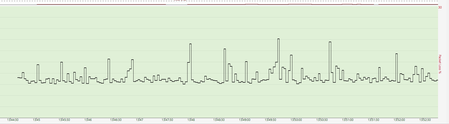

xr500 seems to have more issues than not using it please help
hey i have tried getting my xr500 working but it introduces lag delay and spikes i cant seem to set it up right i will add some ping plotter stuff as you can see ping plotter looks like a 2D new york...

hey i am on virgin media uk 200mb/12mb i have tried withe the fw before the new firmware came out and seemed to be the same and the router is connected to the superhub 3.0 with the latest .308 firmware

3. Or disable all wifi radios on the modem and connect the NG router to the modem, LAN to LAN configure AP mode on the NG router.the router is in modem mode i have called my isp and after alot of prodding and stuff i have managed to get an engineer to downgrade me to the superhub 2.0 since the puma 6 chip is unstable so hopefully this works if not i have no idea where to start since i have followed youtube videos and everything just to have the same outcome so i came here just to see if anyone has knowledge and see what im doing wrong and why im not getting the awesome results everyone else is having
