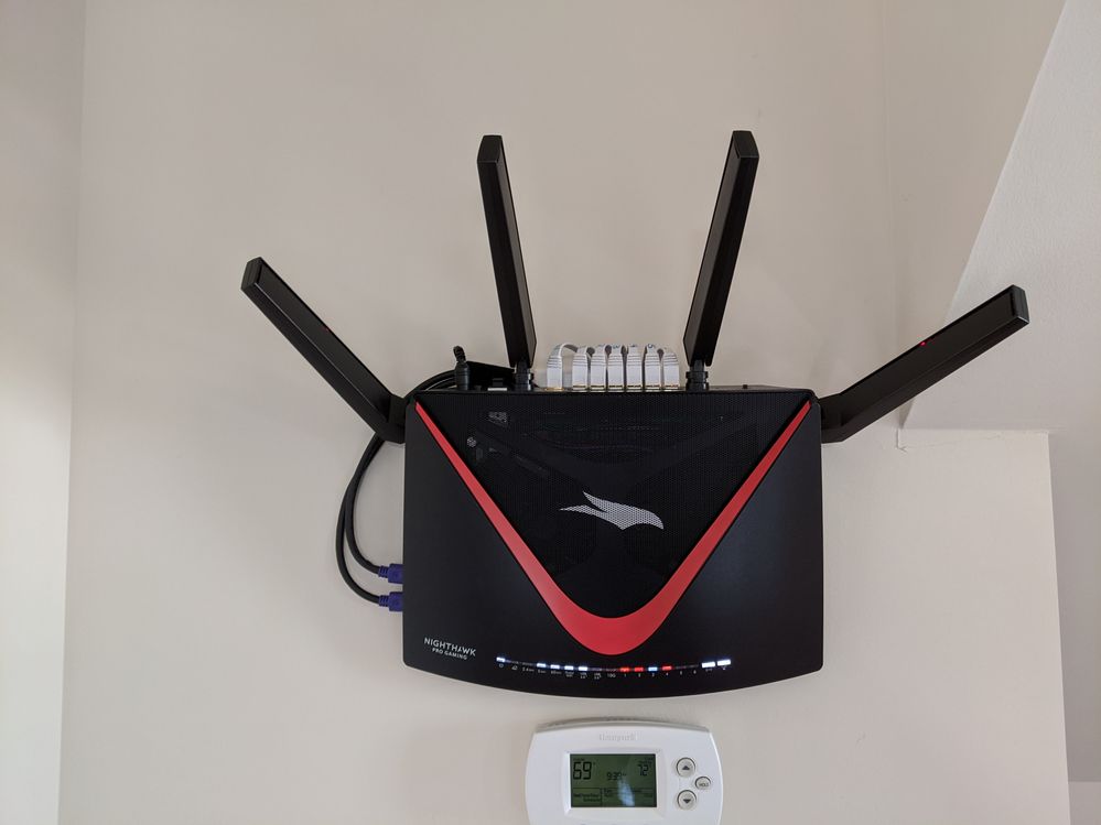

I do not know if router placement had anything to do with it, but I followed the instruction at 2:11 of this video (I did mount it to the wall though):
#DumaOS How To Get Your Best WiFi Settings On DumaOS / NetGear NightHawk XR500 | SGR
I know the video says XR500, but this guy has some great tips. I not only took my XR700 router out of a downstairs media closet and mounted it on a wall in the center of my 2nd floor (of 3 total). But, I also was able to discontinue the use of my Netgear Nighthawk X6S AC3000 Tri-Band WiFi Range Extender EX8000 - which had been previously placed in the center of my second floor. I had used it with my previous Verizon FiOS router with very few issues.
I also disabled Smart Connect and 20/40 under Settings, Wireless Setup as the SGR video stated and used a DFS channel for my 5 GHz. I also followed his Advanced Wireless Settings suggestions as well - including checking "Enable 160 MHz bandwith in the 5 GHz band" which shows differently for the XR500 in the video.
So far, since booting it up late in the evening of 3/4/2020, I have not had any issues. I will continue to monitor for a week or so and report back.

The solution may have been a combination of:
- Better router placement - mentioned in the video at the link above
- Discontinuing the use of my extender (because of better router placement)
- DUMAOS settings mentioned in the video at the link above
- Changing the Retry Attempts on Startup value of the R-Apps to 5
- Setting DHCP reservations in DUMAOS for all my devices (we need to be able to back these settings up)
- Wireless routers nearby on the same channel
