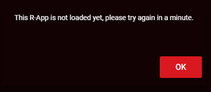

XR700 Bricked!
All of a sudden, my router admin page started to display this (on firmware v1.0.1.48) Thinking a factory reset would solve this, I went through the steps and was able to get through the ...

I didn't make any changes, just noticed the R-app error when I tried to log into my router.

Using the adv_index.htm way to access can you downgrade back to the version you were using prior to the issue occurring then reset and see if its back to normal please?
- kentgiardMay 05, 2022Tutor
Just tried this (again) and it didn't work. The Router becomes bricked again and nothing comes up (and yes, I followed the wait-unplug-wait-reboot process). The weird part is when I re-apply 1.0.1.48, the router comes back up but retains all the settings from before. This tells me that the firmware is not being applied successfully. I now suspect that my memory is going bad (or that there is some other hardware failure).
Does anyone know how to perform diagnostics on the hardware?
- Netduma-FraserMay 05, 2022NetDuma PartnerUpgrading/downgrading does not wipe settings, that's why I mentioned to reset, unplugging won't do that, you'll need to initiate a factory reset from the adv_index.htm page or by holding the reset button in the back of the router for 30 seconds, then release, wait 2 minutes then access
