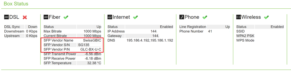

So the router that SwissCom provided has a nice feature that it displays the status of the SFP module and the connection link.
This is how the original Siligence module (Tx1310/Rx1490)looks like:
Siligence
I've tried with a compatible GLC-BX-U-C (Tx1310/Rx1490) module, and - as expected - it works like a charm:

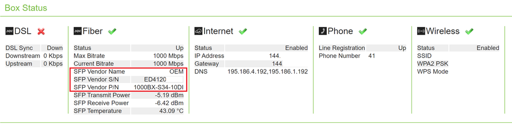

I have also tried with some other compatible modules. No screenshot, but all of them came up without problem.

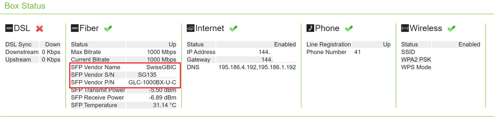

Out of curiosity, I've also tried with a GLC-1000BX-U (Tx1310/Rx1550nm) module and to my surprise the connection was built up without problem. This means that the counterpart is a dual module. So the "old SwissCom confusion" is busted, one can use both modules, I guess. I take this might not be true with every connection, but for me it definitely worked.
