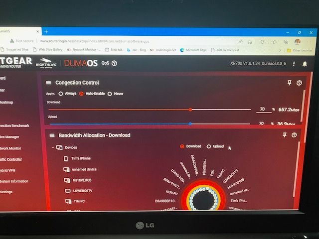

So "upgraded" my XR500 after suffering serious lag issues while playing COD, to an XR700. Updated to the "latest" beta firmware (1.0.1.34_DUMAOS3.0_6) nearly two years ago. Still suffering with horren...

By the looks of it you're not using Congestion Control which is the main feature on the QoS page that eliminates lag caused by the situations you described. I would recommend going through our optimal settings guide to get setup correctly: https://support.netduma.com/en/support/solutions/articles/16000077073-dumaos-optimal-settings-guide-qos
- TimboSlice1967Jan 03, 2023Aspirant

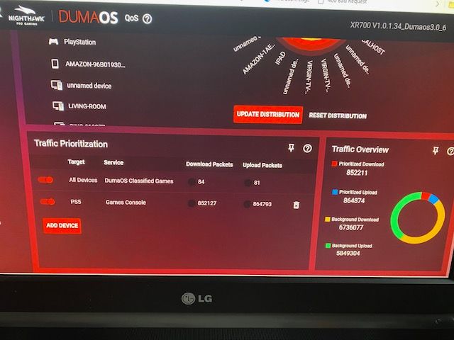

Sorry, photo was taken after another factory reset, this is my normal set up. As you can see, congestion control is set up as per advice.
As for switches, we have a Trendnet gigabit switch TEGS82g which controls our two PC's, cctv dvr and a printer in our office. this is directly into the XR700, then there is another switch , an Aztech gigabit switch that splits for our Audio visual in the living room (TV box, Blueray player, Firestick and AV amp) Our Hive central heating control is direct to XR700 and so is the PS5, anything else (shower, radiator valves, ring doorbell, daughters PS4, Amazon Echo, etc is on WiFi) switching WiFi off doesn't really change much, except if my daughter is streaming video.

- Netduma-FraserJan 03, 2023NetDuma PartnerGiven the amount of devices you have I would suggest switching Congestion Control to Always. While 70% is recommended as a starting point and it works well for the majority, it may not be the right percentage for you. I would suggest experimenting with the percentages to see what gives you the best results. Start at 95% and go down in 10% intervals, once you reach a level where it seems to help quite a lot then try 5% either side of that value to see if it can be fine tuned even more.
