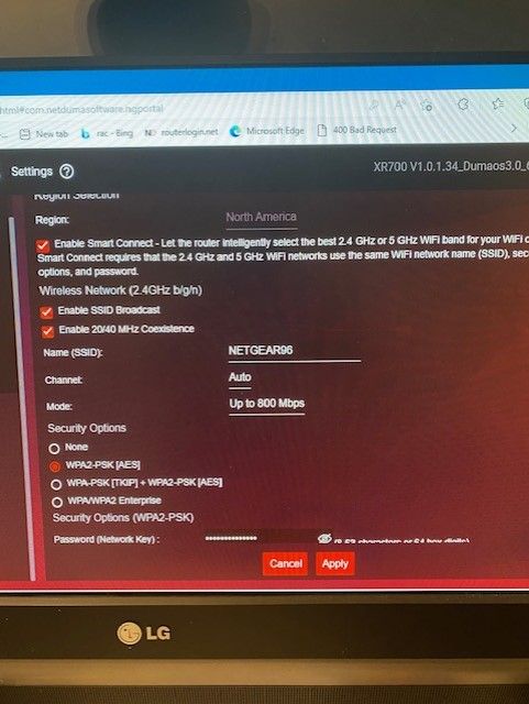

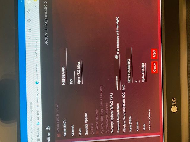

So "upgraded" my XR500 after suffering serious lag issues while playing COD, to an XR700. Updated to the "latest" beta firmware (1.0.1.34_DUMAOS3.0_6) nearly two years ago. Still suffering with horren...

And how is the basic and advanced Wireless Settings configured?
What Wifi channels are you using?

Do you have any wifi neighbors near by?
I would try changing channels to 1 on 2.4Ghz and 40 or 149 and 5Ghz.
I would disable the 60Ghz SSID broadcast as I presume you may not be using it.
Set 20/40Mhz coexistence to 40Mhz.

Will try that and feedback later. When you say set coexistence to 40Mhz, do you just mean disable 20/40Mhz coexistence?
Thanks
Tim
- FURRYe38Jan 04, 2023Guru - Experienced User
Yes.
