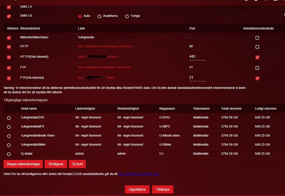

I hope so, attach a picture of the configuration. I have not used ReadyShare before because I had an Asus router before.
- Netduma-FraserMar 19, 2019NetDuma PartnerCan't see the picture as it hasn't been moderated yet. Can you upload to a service and link to the image?
- JingakerMar 19, 2019Guide
- Netduma-FraserMar 19, 2019NetDuma PartnerI think you'll need to tick the first box on the right hand side to local readyshare
- AltsaiMar 21, 2019NETGEAR Expert
did you also enable SMB 1.0?
are you able to find the files via SAMBA protocol? e.g., \\jingmedia?
