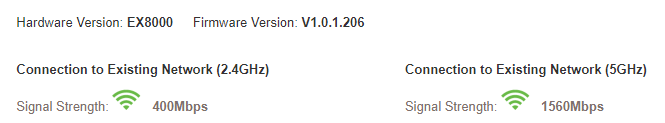

I thing setting DHCP reservations are what is keeping this router stable for the moment. As for your tuning suggestions though, I AGREE! I went ahead and turned off my extender and reset it. I went back to the XR700 and enabled smart connect and unchecked the "Enable 160 MHz bandwidth in the 5 GHz band" in Advanced Wireless settings. I also switched my 5GHz to a non-DFS channel and then turned on Smart Connect.
I then went back to the Extender and reconnected it through the WPS button on it and the WPS button on the XR700. I enabled Smart Connect on it too. I also unchecked "Enable 20/40 MHz Coexistence" on the Extender as well as the XR700. I then noticed the signal strenth of the XR700 as reported by the Extender is MUCH GREATER THAN BEFORE!
Signal Strength of Existing Net (XR700) as Reported by the Extender
I'll see how this works after a while. THANKS FURRYe38!
