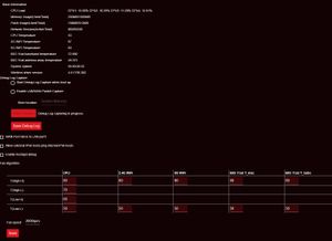

I was wandering if it was hardware issue. And I recently learned about the Debug page that allows me to change fan speed. I've lowered the threshold. Since the CPU temps been less than 60, I get 800s Mbps more often. Please, see attached picture.

In the manual, it states the operating temperature is between 0 - 40 Celsius which would lead me to believe that the temperature on that page is in Fahrenheit as the numbers are much higher but then it could be Celsius and they switch on when going above operating temp. I can appreciate it isn't all that clear, the important thing is you've found a value which seems to keep things more stable for you. If it happens again when the temp is below 60 disable QoS completely and see if the speeds return.

I just checked. Router CPU temp 53 (not sure still whether C or F, if I put my hand over the router it feels more like Celcius). Speed test shows 388Mpbs. Funny thing is that it will be 800s sometime later today.

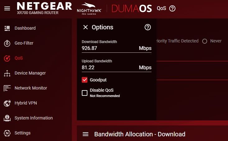

- Netduma-FraserJul 23, 2022NetDuma PartnerQoS fully disabled via the Congestion Control menu? What firmware version are you on currently?
That's the only mention of temperature in the manual we have to go on but you could be right, it may not have any relevance to the internal temp. When the speeds are lower do you notice any reoccurring scenarios such as a certain device being used, a download etc?- onlywisemanJul 23, 2022Guide
What is Congestion Control Menu? I use this option to trigger QoS on/off,
Firmware version is XR700 V1.0.1.48
- Netduma-FraserJul 23, 2022NetDuma PartnerThat's the updated name for Anti-Bufferbloat, sorry about that, I can't see the picture until it has been moderated, could you attach it directly please?
