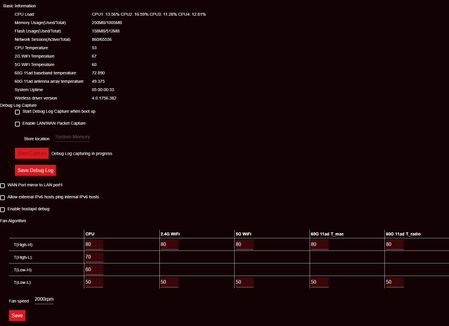

My XR700 has been providing irregular download speed. I have Xfinity gigabit. Directly connected to modem, I get low 900s Mbps. Behind the router I can get up to 800s Mbps. (QoS on, Anti Buffer...

I was wandering if it was hardware issue. And I recently learned about the Debug page that allows me to change fan speed. I've lowered the threshold. Since the CPU temps been less than 60, I get 800s Mbps more often. Please, see attached picture.
Here are my Qs.
1) Is the temperature in F? or C? I guess C.
2) What is the recommended temperature for optimized function of CPU and Wifi processors/antennas?
Thanks bunch.

I've tried QoS on/off and AntiBuff On/Off. DownLoad Speed irregularity continues to happen.
I just checked. Router CPU temp 53 (not sure still whether C or F, if I put my hand over the router it feels more like Celcius). Speed test shows 388Mpbs. Funny thing is that it will be 800s sometime later today.
I thought operating temperature was the environmental temperature where the router should be located at. If 0 - 40 C is what the machine supposed to be, then I should buy a dedicated Fan or AC for the router. 😕

- onlywisemanJul 23, 2022Guide
What is Congestion Control Menu? I use this option to trigger QoS on/off,
Firmware version is XR700 V1.0.1.48
- Netduma-FraserJul 23, 2022NetDuma PartnerThat's the updated name for Anti-Bufferbloat, sorry about that, I can't see the picture until it has been moderated, could you attach it directly please?
