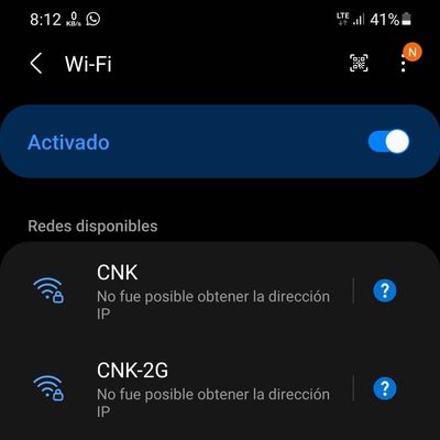

Hi, since I bought the XRM570 (XR500) I am having this issue: From time to time, randomly, the router does not assign an IP address over WiFi. The devices indicate "could not assign or get an ip ...

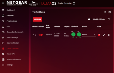

- Netduma-FraserJun 23, 2021NetDuma PartnerCould you make Traffic Controller rules for each device and allow all traffic and see whether it makes a difference?
- conkerickJul 21, 2021Tutor
Hi, sorry for the delay. The problem had not occurred again until yesterday.
The "Traffic Controller" tip doesn't do anything.
All my WiFi devices are like this:
If I see the router log, it has too many DHCP requests from my devices (they all have reserved ip's). They happen almost every second.

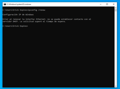

Then in cmd "ipconfig / release and ipconfig / renew" and I got this:
"The DHCP server timed out."

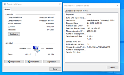

I thought that the problem was only in WiFi, but it turns out that it also happens by cable, only that my pc had a reserved IP and a fixed IP.
At that moment my wife tells me that she does not have WiFi on her phone or on the TV. When I check, no device could connect to WiFi, my computer (only device connected by cable) could not connect either.
So DHCP issue is general, but it is the first time that the router freeze completely .

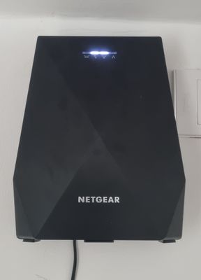

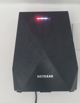

I ran to my computer to check if the issue was the same but I found the extender lost communication with the router:
Router Link LED: OFF
Can't access or ping the router (from my pc which is wired) and a few seconds later the extender was like this:
Router Link LED: RED
Then I was able to access and ping the router. Few seconds later the Router Link LED was solid white.
