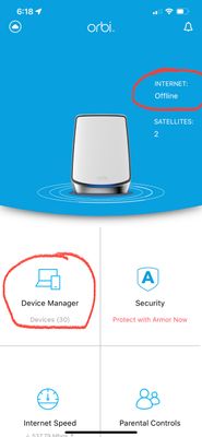

Device Manager error CDIL-API-FAIL (RBR750)
I've recently updated to the latest firmware for my RBR750 system and since the Orbi app (iOS 15) has a few issues: 1. Every time I tap on Device Manager I'm getting an error "CDIL-API-FAIL" erro...
