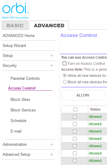

The 'app' is not particularly helpful in a number of areas. The Orbi web interface (http://orbilogin.net ) provides a method to remove these records. With a web browser, navigate to the Advanced Tab, Security Menu, Access Control:
There are three tables on this page. The second table (scroll down to see it) lists every device that is "Allowed" on the network but is not currently connected.
If Access Control is not enabled, you must temporarily enable it to modify the tables. Scroll down, mark any devices that are no longer relevant, click on Remove from the List. Then restore the enable setting to the original value. You probably have to click on "Apply" to make the setting "stick".

- BGreensAspirantThank you. I successfully removed them. I didn't like having stuff on the network of I don't know what it is.
