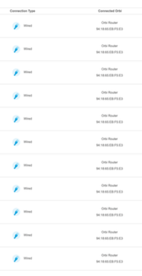

Crasje I thought you would enjoy this, I found it in one of my bug reports on the device list. Everything on my network was wired and attached to the router! So while I gave you some things to dig in to if you are so inclined, my advice would be not to worry about it if the network is otherwise running well - connections solid, speeds good, etc.
I have learned not to trust the device report if something there is odd or in conflict with other data, objective or subjective, I perceive about my network!
