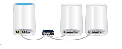

What is the distance between the router and satellite(s)? 30 feet or more is recommended in between RBR and RBS to begin with depending upon building materials when wirelessly connected. (MORE THAN 30 FEETS SOME RBS ARE CONNECTED WITH WIRED CONNECTIONS)Are the RBS connected directly to the RBR or is there a network LAN Switch in between the RBR and RBS?
- Deepak_MehtaMar 01, 2021Aspirant
RBR is connected to cisco unmanged switch, from there ethernet connections are attached to RBS
