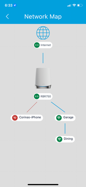

Network Map showing a cellphone as one of the Satellites
I have an RBR750 and two satellites, when I look at my network map in the app, my daughter’s cell phone shows up as an additional satellite. How can I remove it from my network map? I have reset and ...

Has a power off for 1 minute then back ON with the ISP modem and router/satellites been performed since last update?
Be sure to restart your network in this sequence:
Turn off and unplug modem.
Turn off router/satellites and computers.
Plug in and turn on modem. Wait 2 minutes for it to connect.
Turn on the router and wait 2 minutes for it to connect.
Turn on satellites, computers and rest of network.
Has a factory reset and setup from scratch been performed since last FW update?
- ChazzyNov 28, 2023Aspirant
Thank you for the tips! I have rebooted, but not in that sequence, I will give it a try today!
I have not done a factory reset ever, if the sequence does not do the trick, I will do a factory reset.
Thank you for your guidance and help!
