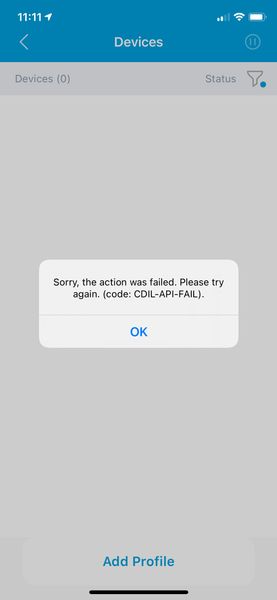

Orbi App Bug with Firmware 2.7.1.60
I updated to Orbi firmware 2.7.1.60 last night and now when I go to view the devices connected to the Orbi via the Orbi app I get the following error. This happens on both my iPad and iPhone so it se...

Having the same problem after firmware upgrade. Cannot see list of devices.

Updated to Iphone app version 2.7.0.28 on 11/16/2020. Still have the same problem accessing device information via the app on the Orbi system using firmware 2.7.1.60. Clicking on "Devices" results in a delay followed by "Could not reach server. Try again later (code: CDIL-API-FAIL). OK"

1) 2.7.1.60
2) iPhone App 2.7.0.28
3) CDIL-API-FAIL
No devices shown at all on RBR50 (router) OR on any of the Satellites RBS50 and RBS20.
