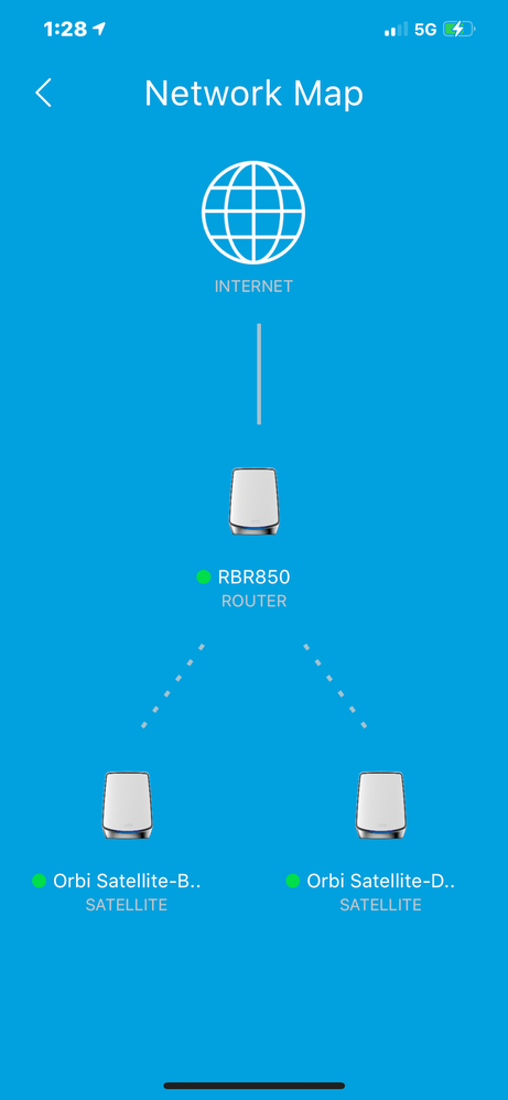

- FURRYe38Nov 03, 2021Guru - Experienced User
I have Orbi app connected to my 8 series right now while at work:
This morning I also saw the app was connected using Anywhere access while at home however I did have a Locally Connected entry in the list of devices Orbi app could connect too.
